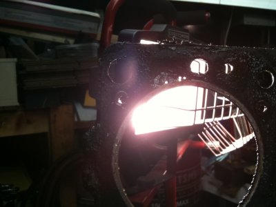

Had the same symtoms on four different GM cars that used DexCool antifreeze...had to replace head gaskets on eachIMG_0820.JPG
head gaskets do seem to be fairly common, sometimes they are run with problems like you speak of and then you start to see cracked head issues.
