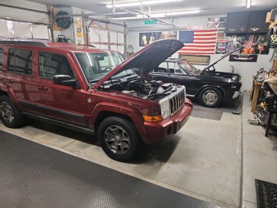

Need help. Anyone know where I can take this jeep to? I am DONE messing with it myself.
I am at a loss. It's my sons Jeep. Has 105K miles and has had an easy life and with being maintained.
Started with Jeep dying (running off Battery). Put different Battery in. Starts up barely gets me home and in the Driveway.

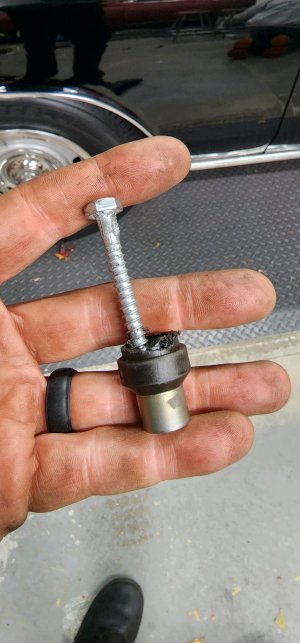

- Replaced Crank Sensor (was the biggest Mother Fucker to get out as the original crumbled when trying to get original out)
- Crank Sensor did not change anything.
