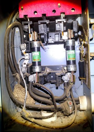

One of the two Big main fuse’s outside in small panel before meter?
Use a continuity tester across the fuse. If it beeps the fuse is good, if not then it's blown.

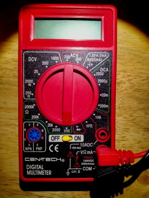

Please don't laugh......what setting do I use on this to check it?
I can check it with this correct?
Setting looks good where it's at. Turn it on look at the screen then touch the 2 leads together. You should see it change. Then when you go across the fuse it should behave the same as you touching the 2 leads together.
BE CAREFUL.... There is power in the box. BIG power
Even if you pull the disconnect that's just the power going to the house. The power from the lines into the box is still hot.

Hmm... Don't have any separate fuse box in the house before the main panel do you? I know my house has one, I don't know why but it does.
Did you pull the fuses to check them or where they still installed in the panel?
Ok great, that was going to be my next question.
Maybe half the house is one half the panel?
Maybe trip the main and reset it?

I tried the 750 ACV setting & couldn't get anything from either side.
This so beyond me. I'm going to try to call DTE at 8am.
