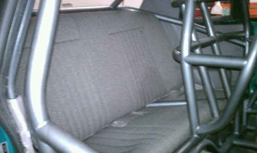

Thats the only picture I got of my car currently. Its a 25.5 cage with the back seat in there. Like mentioned you just have to take some of the foam out to fit under the bars...
Mini tubbed fox with back seat. Went in with little issue. Had to do minimal trimming to sides of rigid plastic backer on top cushion. Made new mounting tabs for seat back.
