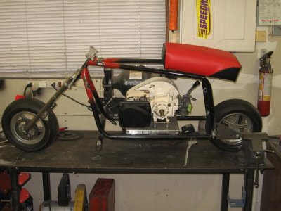

Since my Coronet isn't at home and I had to take a break from doing bodywork so I can keep whats left of my sanity, I started building a new minibike. I picked up the frame and a bunch of parts for 50 bucks, garbage picked a pocket rocket, and had a 175cc 2 stroke laying around. I lowered the top half of the frame because that 2 stroke is short and it looked funny, extended the rear wheel, and kicked the forks out a bit for some rake. I gotta get some 7/8" tube to make new forks, the ones on there are for mock up. I'm recycling the triple trees, tires & rims, and disc brakes from the pocket rocket, and maybe the exhaust pipe and expansion chamber, not sure yet, it might be too small. I gotta figure out what I'm doing about the seat too, it's held on with tape right now.
Hey looks good! I was building barstool racers for a few years. I think I built 12 of them. The last one was clocked at 48mph. Look at American Powersports for parts. They have shocks and all kinds of minibike parts.
