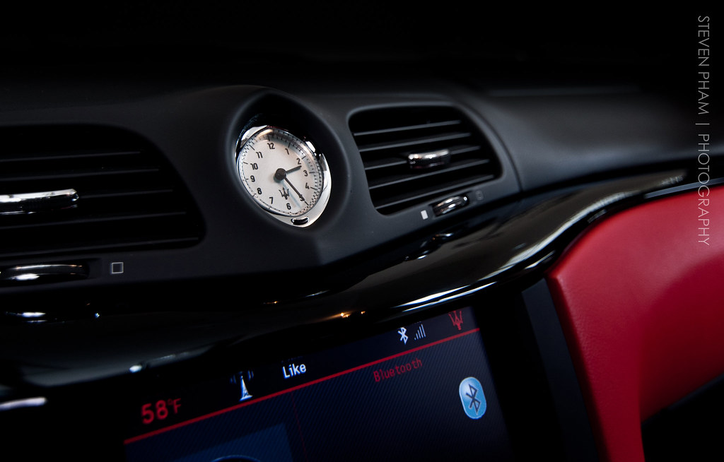

Several days later, we came back to finish the Gran Turismo's interior. The work began with a vacuuming of the entire interior, and because most of the hard surfaces were lightly dirty, 1Z Cockpit Premium was used to clean, dress, and protect the majority of the interior surfaces. The leather was cleaned with Leather Master Strong Cleaner and protected with Leather Master Protection Creme. Interior windows were cleaned with Klasse All In One. Cup holder inserts were cleaned with All Purpose Cleaner before being wiped down with 1Z Cockpit Premium. Painted portions surrounding the doors were wiped down and protected with Sonus Acrylic Glanz.

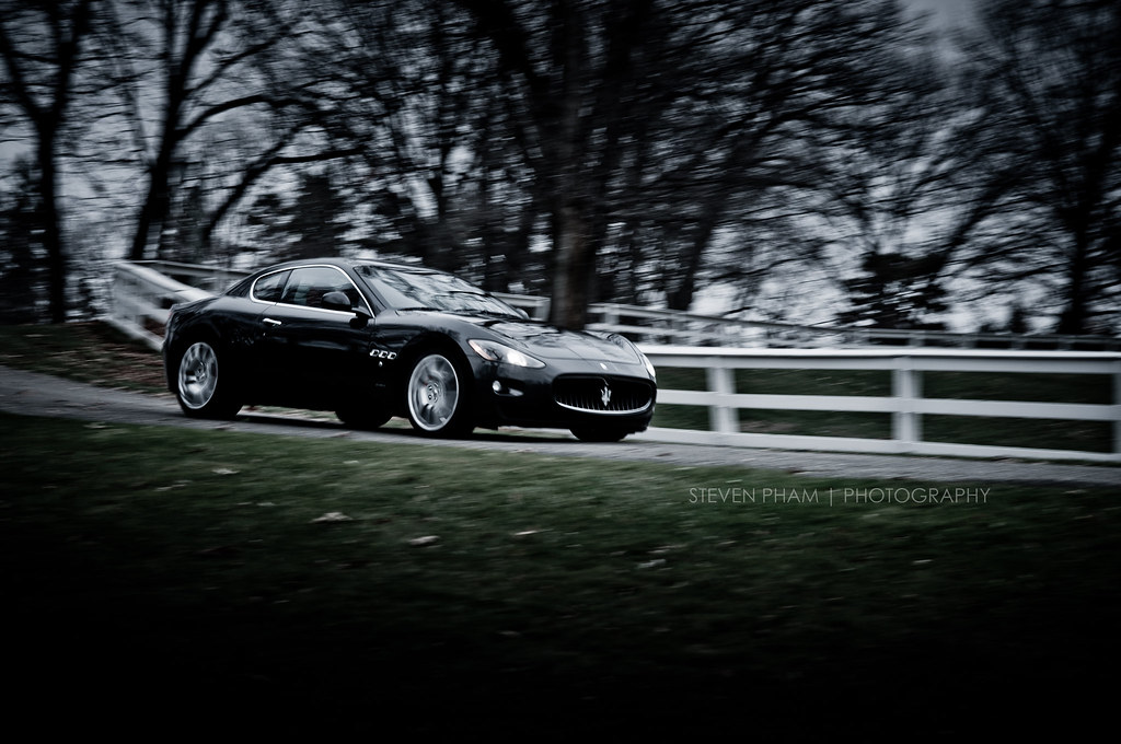

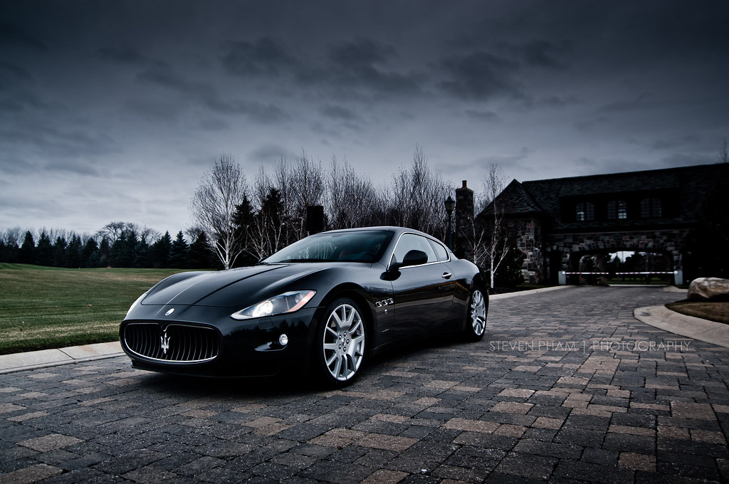

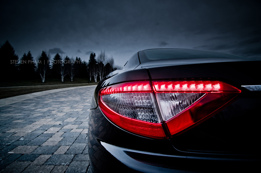

As we put the finishing touches on the interior, photographer Steven Pham showed up to lend us his artistic talents. The video he took captured the final exterior wash in prep for the photo shoot, as well as the beading and water sheeting capabilities of the C1 coating. Although it was a very cloudy 40 degree day, he did an outstanding job capturing the beauty that this car has.
