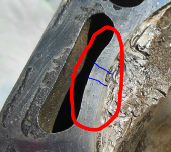

here are the pictures I have:
does this even look like it can be repaired?
That can be fixed. Mine broke a valve then smashed it into the combustion chamber. I had to use a slide hammer to get it out and it was able to be repaired.
That appears to be cracked between the valves, I'd have that pressure checked first. Also I wouldn't be to worried about the nicks. None of them hit the sealing ring. They can be ground down to smooth the out but they won't affect the sealing.
I don't think there's a crack between the valves, where are you seeing that?
the problem I was having was coolant in the oil, it was leaking right here:
There's usually a reason the seat came out. If there's a crack and it expanded that's why the seat fell out.
