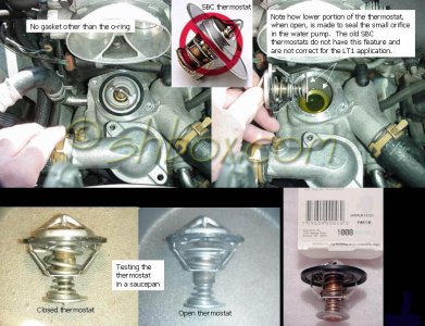

I'm going to swap out the thermostat.. he said it has a failsafe in it now that stays open just a tiny bit. I think with the temps being so cold it never gets a chance to warm up completely. It runs at between 120-160 right now.. i'd like to see it stay around 180 give or take.

If everything checks out externally, the next place I'd look is the thermostat. Make sure it's an LT1 stat, not a conventional SBC stat. But, the erratic temperature swings sound more like an unpressurized system.
Everything checks out Mike.. only thing left is the thermostat which from what the guy told me is a "cold" stat, so i'm thinking it has a 160* in it. Might not have to mess with it though now that its' warming up outside :)
Could be a funky or wrong stat. Keep me posted, I'm happy to help out. I'm trying to think what happens if the bypass circuit is not closed when the stat opens.
Sounds cool, is it AWD?? Pics?? I just changed t-stat that was newer b/c the fail safe worked and stuck open. Replaced it with a Normal one and heat is back.
