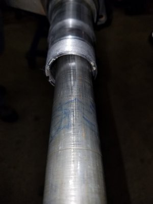

Does anyone know a good welder or shop that can tig weld axle tubes? Long story short, I need to get my axle tubes welded to the housing. I just had my axle built and this wasn't done, (5) weeks late... Hoping I can have them done assembled w/o warping. I am really hoping that I don't have to tear it back down.

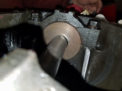

I would tear them down and have a true bar put through the housing to be on the safe side...
You need a jig, and I highly recommend a fixture plate as well. DO NOT let anyone just slide the tubes in and even start welding without having the correct bar and pucks secured in the housing. It will be unusable in the end and need to be completely cut apart again.
If it's a 9" style housing just pull the 3rd member out. If it's a 8.8, 12 bolt, Dana, etc then you need to take the guts out of the center.
The tubes should actually be welded first to the housing, then the housing ends are welded to the assembly laston with a jig with alignment bar. I have a feeling any shop that you call might not weld what you have, you might have to buy new tubes and new housing ends and have everything welded in correct process to ensure good alignment. You can box what you have up and send to moser or strange, they actually have really fast turnaround. Locally i'd try skinny kid race cars too. I wouldn't skimp on the rear end housing, can lead to bigger problems when you are putting the power down.

Thanks everyone! Got it welded by an old hot rod fabricator near my house. He did (6) small increments around each tube to keep the heat down. Time for paint.

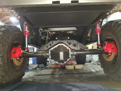

I understand your car your rules... I just want to show you what happens when it's not in a jig... We thought it was going to be good on this XJ build when we tig welded this truss onto this 14 bolt rear end... We were dead wrong...
It was welded by the best hands down and still warped...
You don't check to see if it is warped from the outside. Hell I've seen rear ends where the tubes were slightly bent/angled but housing end to housing end it was dead nuts straight through. That's what really matters. The only way to check for straightness is through the rear end internally. It does not matter one single bit who welds it. A few tacks is enough to warp and bend stuff.
