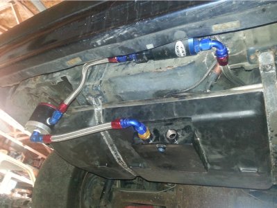

I have done a ton of research on this exact subject with the same horsepower numbers in mind and the protuner 750 was the best choice and so far it has performed flawless....the big thing I was looking for was continuous duty and flowing enough fuel to support around 1k at the wheels with e85..I ran a -12 from the tank -10 from the pump split into 2 -8's one to each rail... I haven't put down 1k yet but have made some changes this winter which should get me closer but I'm not worried about the fuel system it shouldn't be an issue

Ive got a 4303 in mine and it made just under 1000rwhp on turbo blue with no issues. I think the pump will support 1300 on gas provided youve got the injector
