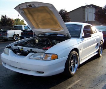

Kennebell2.6's junk
Engine 438 rwtq and 448 rwhp
-4.6 Iron block
-Diamond pistons
-Eagle rods
-Cobra crank
-Stock p.i. heads
-2.6 kb @ 10psi
-BBk shorties
Built and tuned by Alternative Auto
Transmission
-4r70w done by Alternative Auto
- Stock Mercury Marauder convertor
Rear end
-Stock
-3:55 gears
Hopefully this winter I can up the boost with some alcohol injection and get the numbers in the high 500 range.
I like the sleeper look.....nothing screams "hey look at me!" until you floor it.
What kinda work did Alternative do to your tranny?
Not a clue. I was told 2 years ago and compleatly forgot. I think alto red clutches, kolean? steels, and shift kit. It holds up though to some serious ass whoopins.
