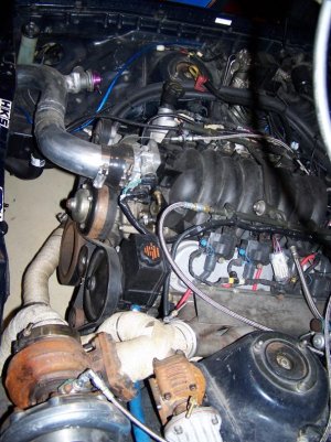

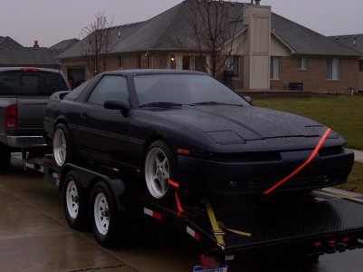

I just picked up another project car. Hopefully I can figure the electrical so I can get it running. Anyone good with LS1 Electrical. Car needs some work but should be fun. Here are a couple pics.

that isn't Alex's ride is it?
I got it from a guy named Matt. He owned it for a couple years.
The car is wired with a painless wiring kit, but is the 98 LS1 setup, the guy has a 99 computer for it but said some things need to be changed befor I can use the computer from the 99. There is no mass air and was told this setup can be tuned to run without it????
Nice car the previous owner wanted 2 trade me for the capri but I'm not big on foriegn cars looks llike a cool project he said he had a lot of cash in the car
Yes, without a mass air sensor the car will run in speed density mode. I have my car running that way. There are some drawbacks of running the pre-2001 computer in SD unless you run a custom OS to make use of both VE and spark tables.
just a couple wires moved at the pcm if i remember correctly. not hard

Car looks nice...I'd like to find one of those as well, stock turbo engine would be fine as well...
