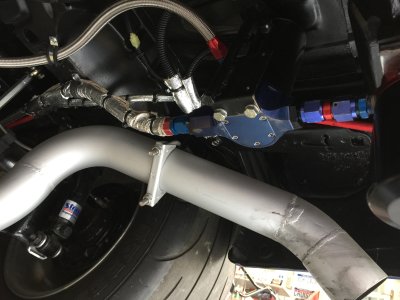

Quick fuel system overview. The car has a Magnafuel QuickStar 275 pump that recirculates to the cell, -8 line from the pump to the regulator block and two lines to each side of the carb. The second regulator has the nitrous system.

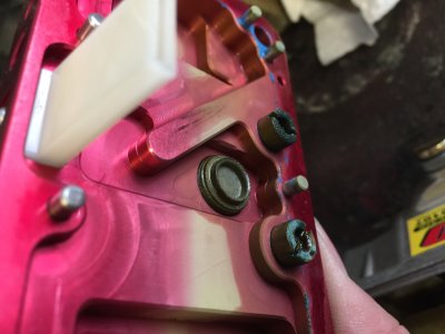

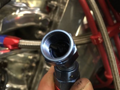

So after seeing the secondary were not working, I decided to pull the carb (AED Systems custom 820cfm) to give it a quick cleaning. When I took my fuel lines off I found this long black string of crud behind the fitting going into the rear bowl. The front had a small piece, but not as bad as the rear.

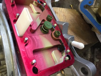

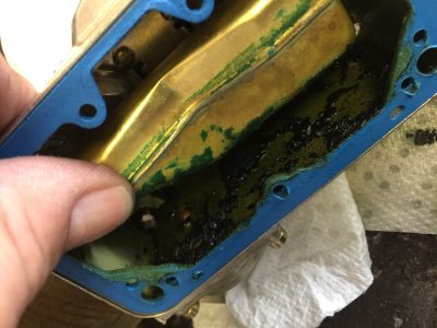

I tore down the carb and this is what I found;

The cell is clean, so breakdown of fuel cell foam is occurring, plus the pump recirculating would have filled the cell with shit if it were the pump. I’ve been running 110 unleaded rec fuel in it for the last few years, but I think it may have eaten my fuel lines from the inside out.
There looks to be a waterline on my metering blocks too? Any thoughts?
Time for new lines, that race fuel is some hard core stuff. Might want to consider running it dry for storage after the repairs .
are the lines rated to the fuel being used? any treatment added during storage containing methanol?
I sent you another PM Chris, but I think these guys nailed it already. Also, get rid of the fuel cell foam before it's next.
Absolutely
What brand of line was it?
I’ve seen jegs brand break down quick.
That black strand in first picture will get cut out of the line when installing say a jegs fitting on aeroquip line or racepartssolutions fittings on earls.
Just examples. ID doesn’t always match. Fitting style too. Don’t re use a non reusable fitting, even though it’s possible annnnnnnd I’ve done it...... don’t do it

The cell is still clean. So no issue there yet, but I will pull the foam from the cell now too. The hose come from Jegs, so it’s possible that I got a length of hose where the rubber wasn’t fully vulcanized.
For years I ran 110 leaded Torco and never had a problem with any of my stuff. I have 110 unleaded in this car and have issue after issue. Should I go back to run leaded fuel again?? Any thoughts? Similar experience?
If you want to run the same fuel just swap hoses to PTFE lined stuff. I run the Series 6000 hose from Fragola and have no issues with ethanol.
