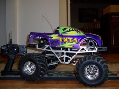

its starterd off as this. 16x2 speed gems 2 motors, with a super rooster, and a single battery. lets just say 18mph wasnt too much fun. it couldnt crawl over a mole hill, let alone go threw the grass hardly. it just lookied cool. spent around 400 on it, just to have the stupid thing. needles to ay it only lasted about 3 weeks. the 4 link rod ends are made outa plastic, and the cantilevear suspension just kept popping them off, so i go board fast, and didnt touch it for about a year.

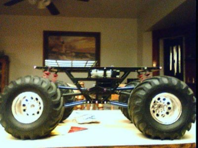

about a year later i decided to ditch the canti set up, in favor of a coil over set up, and we ended up here, sorry for the poor cell phone quality pictures.
also, note, the two speed e-maxx tranny with the 550 motors. this was the only pic i got of it threw this transfromation of its life. the canti set up got lost about a year ago, and the emaxx tranny got put in with yes those are zip ties about 2 weeks ago.

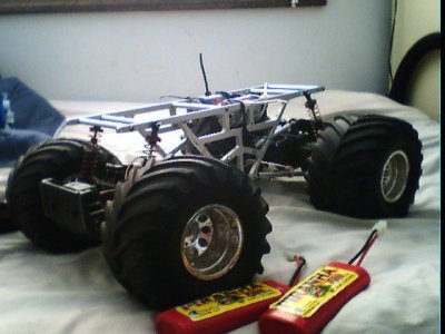

sooooo, after i decided i could make the emaxx tranny work, i made up 2 mounts for it, outta angle iron, and bolted the stupid thing in. it turned out good, so i decided to keep rolling with it, and went and wasted a heafty chunk of change on getting it powder coated, and buying 60 dollars worth of anodized aluminum washers and lock nuts.
this is how it looks as of now, but i'm just mocking it up, i still need to buy screws, and a few other small things before the chassis is done and ready to get electronics.

now instead of only 18mph, it should go somewhere between 30 and 35 in the grass i'm hopeing. it should pull wheelies on command, and have pleanty of run time, somewhere around 25-30 minutes on 4200 nimh packs.
im gonna be useing the water proof evx2 speed controll, and reciever, from traxxas. its gonna be quite the basher i hope. if you notice where the transmission is its pushed further to the back of the chassis, thats cause i'm mounting the batterys in the front of the truck, to help with when im climbing hills with it. the first hill i'm trying with it is probally a 45-60 degree grade, and around 50-60 foot high, with alot of fine pebble. i've actually climbed it before back in high school with a team losi xxt with a 17x1 speed gems, and a 2000 pack, with paddle tires. so i have confidence in this doing it also. i am actually mainley build this truck just for that hill. lol. what a freakin waste right?
