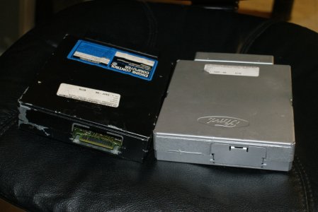

The black ECM has the correct tune in it but does not work. The silver one is the new ECM with the stock tune. There is no chip from the black one that goes in that opening. Is there a chip inside the ECM I can remove from the black one and use to update the silver one?
