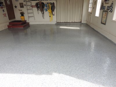

Since I painted my garage floor again, the walls look kinda bad and I want to paint them. The last time was about 10-12 years ago and they are just white. Has anyone used a cheap airless sprayer before and how well do they work?

For a garage that size I would buy a good roller and roll it out. If you spray you will have to tape it all off to avoid over spray. Not worth the head ache in my opinion. Either way good luck and the garage is lookin good.

Roll it......no mess, very little prep.

Yeah that is definitely a roll job. With a sprayer you'd be masking 100% of anything you didn't want overspray on, including the floor. Rolling, just put a couple inches of tape around the edges of everything and a drop cloth on the floor where you're working and you're good to go.

Beside overspray, having not been painted in that long, the walls will be dry.
You'll need a few good heavy coats of paint on there to freshen it up.
