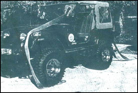

Anyone remember the picture of the jeep that had a tow strap come thorough the window and THROUGH the head rest from doing the same thing?
Edit: Found said picture.
I used to wheel with a guy that died like that. he was pulling someone out of a mud hole and their tow hook gave loose, the hook on the end of the strap went thru the back window and hit him in the head
