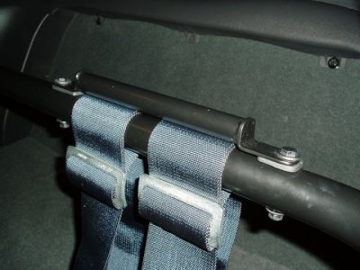

Also if you use the wrap around style for the shoulder straps they can "slide" along the bar and therefore will not pass tech.......that is why I welded the tabs on my bar. They do sell harness stops if you do decide to use the wrap around style. I attached a picture to show what I am talking about.
