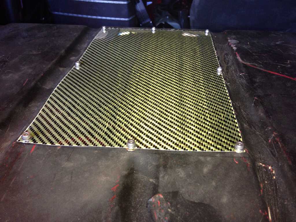

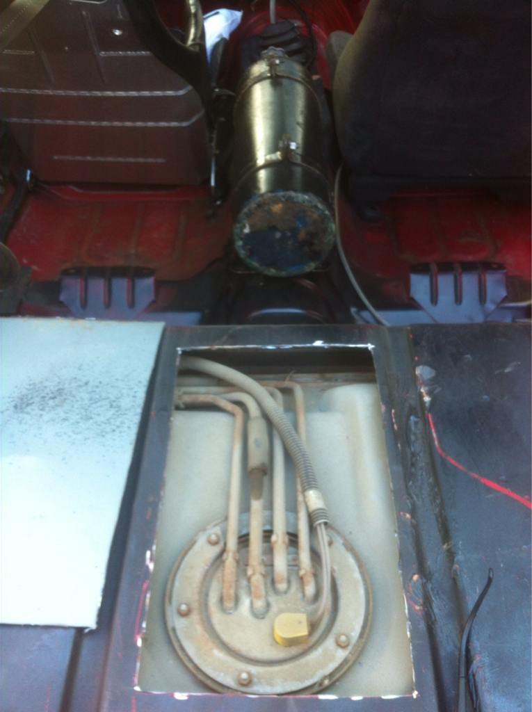

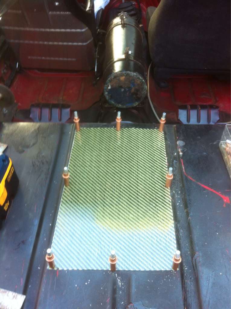

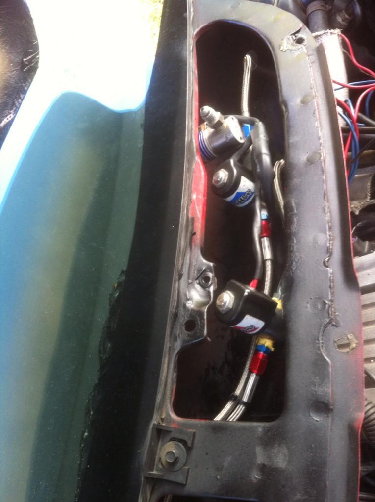

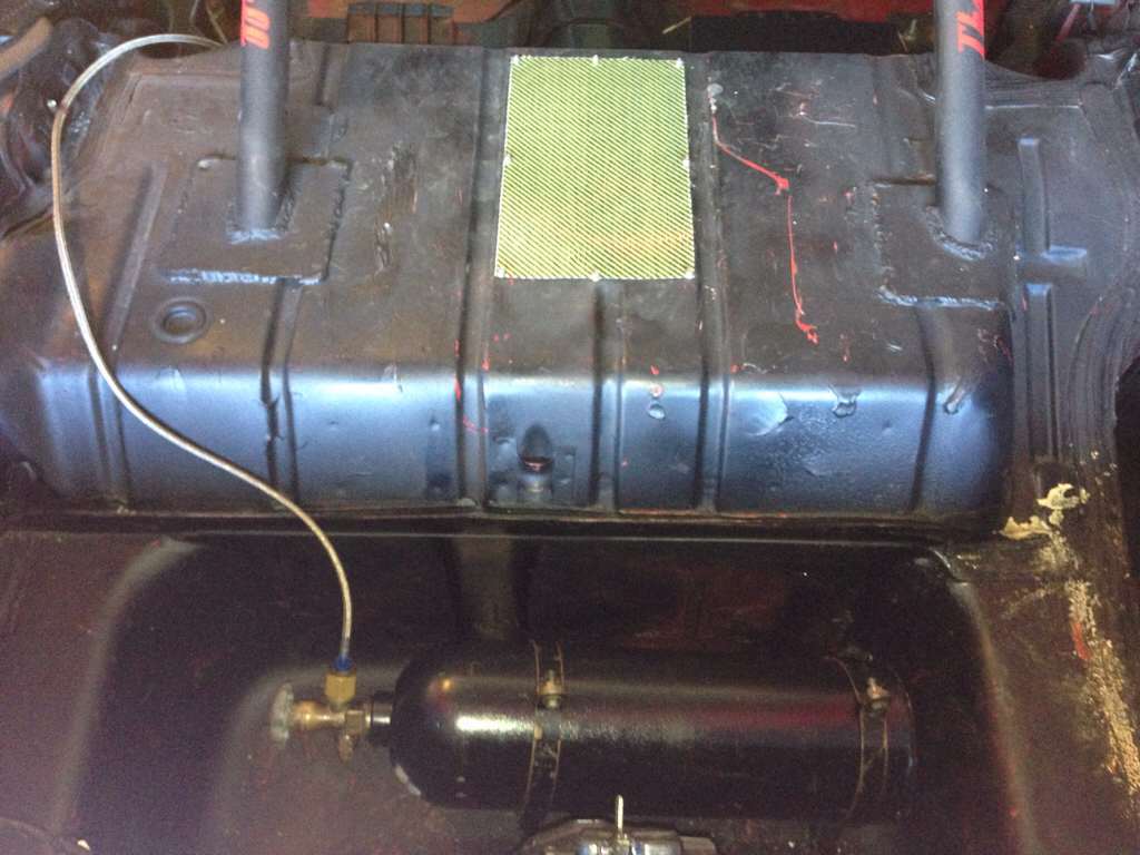

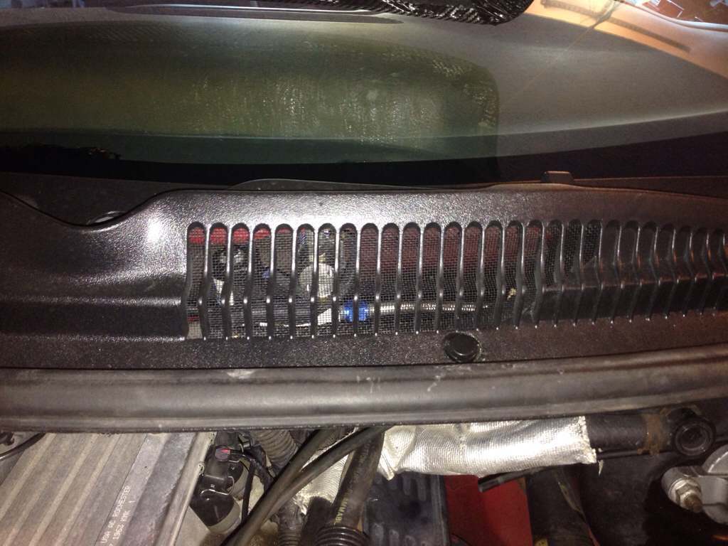

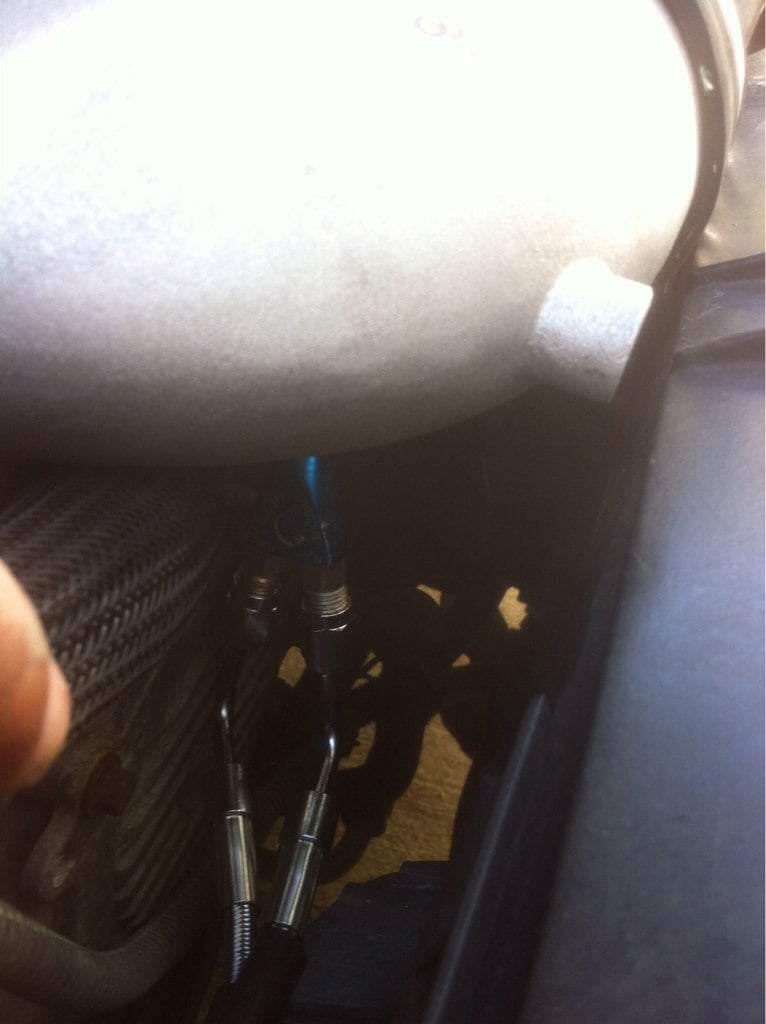

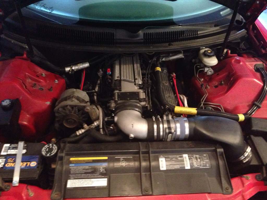

Dropped my car off to my friends business, Antilag Racing, over the weekend to have a wet nitrous kit installed. I couldn't be happier with the way things turned out! It is much cleaner than I expected and without it being pointed out most won't even know it's there. All the solenoids are hidden in the wiper cowl. They also put in a 255 fuel pump for me as we'll and made a badass kevlar cover for the fuel pump trap door. i'll be spraying a 100 shot on my LT and once i swap my 5.3 in probably spray that as well.
So far I love spraying! I'm going to check my jets and maybe order some different ones. I left the ones in the kit that it came with and I think it's a little rich. I really need to get a wideband on the car.
I'm a dumbass and ordered the wrong jets, I got NOS and needed NX so I'm waiting for summit to exchange them out. Right now I'm running a .036 fuel jet and I should be running a .028 so it's a little rich when spraying. Also need to pick up a bottle pressure gauge so I can get my bottle warmer hooked up.
the bottle warmer takes alot of power. just watch it when your in the staging lanes because you will kill a battery fast. i had more luck with a torch.
