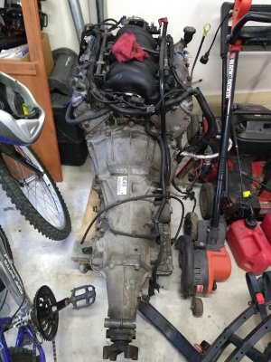

LS1 and 4L60E out of a 2002 Trans Am. I am probably going to put a small cam in it along with a 2300 -2500 rpm stall torque converter. I have no aspiration or intent for anything more than that in the future so I'd be looking at 400 rwhp max, probably closer to 350. A switch to a 28 spline axle would be nice but I'm not sure that combo would even break a 26 spline. I'm on a budget and picking and choosing where to spend my money. It doesn't help I keep remembering things I initially forgot to budget for like wiring harness and cat back exhaust system. I might even forgo the cam for now.

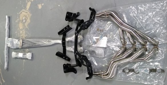

Here are the parts I have collected so far. My K-Member that I ordered pre-shutdown is now in the house!

I still have the stock set of pushrods out of my '02 Z28 in the garage. Heck, I even have the stock low mileage catalytic converters out there. I wonder what those puppies are worth? Not too many parts left, though. I still have a set of ported MAF ends in the basement. Beyond that, I can't think of much. The cam swap here would be even easier. I don't even have to remove the water pump because it is already off.
