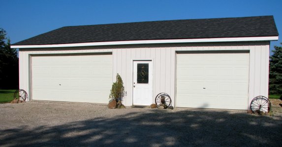

I've owned several buildings. The one I now have at my home property is a
stand alone 30'x40'. It has Fiberglass batts in the walls, foam & foil panels
for ceiling. I also have full drywall on all sides.
It is more than sufficient. I simply can't see spending that extra $3,500 on
more insulating. I would think that money would be much better served
somewhere else.
