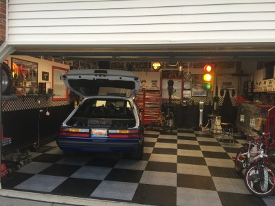

Mine is done in race deck. I love it. Never cold. Everything wipes off it and easy to install. The garage where I store the other car is done too. No floor sweating in the spring. Great stuff. The only con is you can't weld on it, and you need a plate under Jack stands to spread the load or they will mark. I did the paint thing for years and nothing stuck correctly regardless of how it was done.

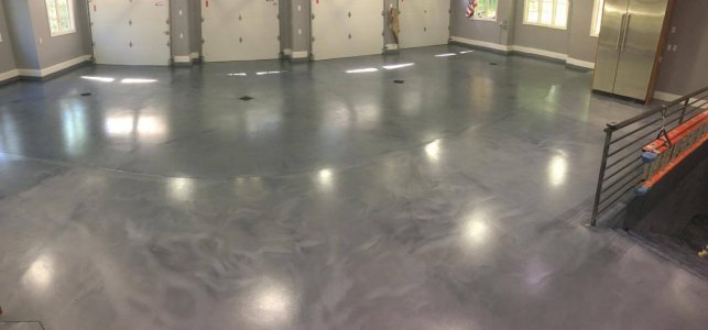

I have too much other stuff I need to buy to drop 3k on a garage floor.
Precision epoxy flooring did my new 1500 Sq ft floor coating in my new shop and it looks awesome! 15 year warranty and they have a great reputation around here.
