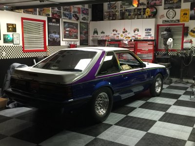

Maliboost on RaceDeck Diamond garage flooring
AVAILABLE IN NINE STYLES AND FOURTEEN COLORS
CREATE THE GARAGE YOU’VE ALWAYS WANTED
DESIGN NOW »
previousnext
THE ORIGINAL AND STILL THE BEST MODULAR GARAGE FLOORING
RaceDeck Garage Flooring is engineered to turn your garage into a showplace while withstanding even the toughest garage environments. Transform your garage in hours, not days with RaceDeck’s patented garage tile system. No tools for installation, no mess or toxic fumes associated with coatings and epoxies.
RaceDeck offers garage flooring for all your needs. Classic designs like Diamond and CircleTrac® showcase your space in timeless style, while cutting edge products like TuffShield® and Free-Flow® create custom high-tech looks. Choose from our 9 styles and 14 colors or opt for custom colors, logos, and designs to create the garage you’ve always wanted.
With 25 Patents and Counting, You Can Rest Assured You’re Getting the Most Advanced Modular Garage Flooring in the World.
VIEW PRODUCTS »
KEY BENEFITS
15 Year limited warranty
Odorless installation—no toxic fumes
Installs in less than one day
Not affected by moisture
Slip resistant when wet
Available in self-draining design
Easily removed for use elsewhere
Easy DIY installation
No shot blasting, acid washing, or surface prep required
No damage if foundation concrete cracks
Quick and easy to repair
