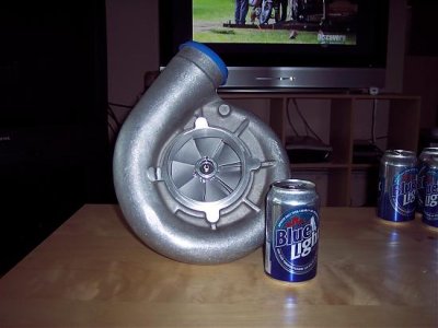

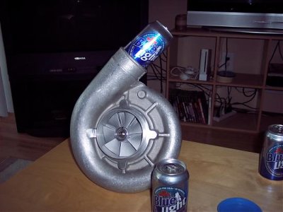

I got my blower back after 19 days from the day I shipped it in. This was an upgrade from a V2 S-Trim to the SI-Trim impeller as well as a straight polished discharge. Total cost was $730 which included the volute and impeller upgrade as well as a minor rebuild and shipping. If you dont want a rebuild the total cost would be $330 plus shipping. I was advised to do a rebuild not because my blower was out of spec but because he said the SI-trim spins faster and would benefit from the newer style bearings. Basically for good insurance, not that the rebuild was because of shaft play or bearing noise.
They also sent me back my original S-trim impeller and volute! Here is a comparison via pics:
its hard to see but the impeller is definitely larger on the SI-trim, the curved sections are much more pronounced.
SI-Trim:
S-Trim:
and side by side:
I will be installing it as well as my front mount intercooler in the next couple of weeks, stay tuned!

OK, So here it is!
SI-Trim:
S-Trim:
and side by side:
