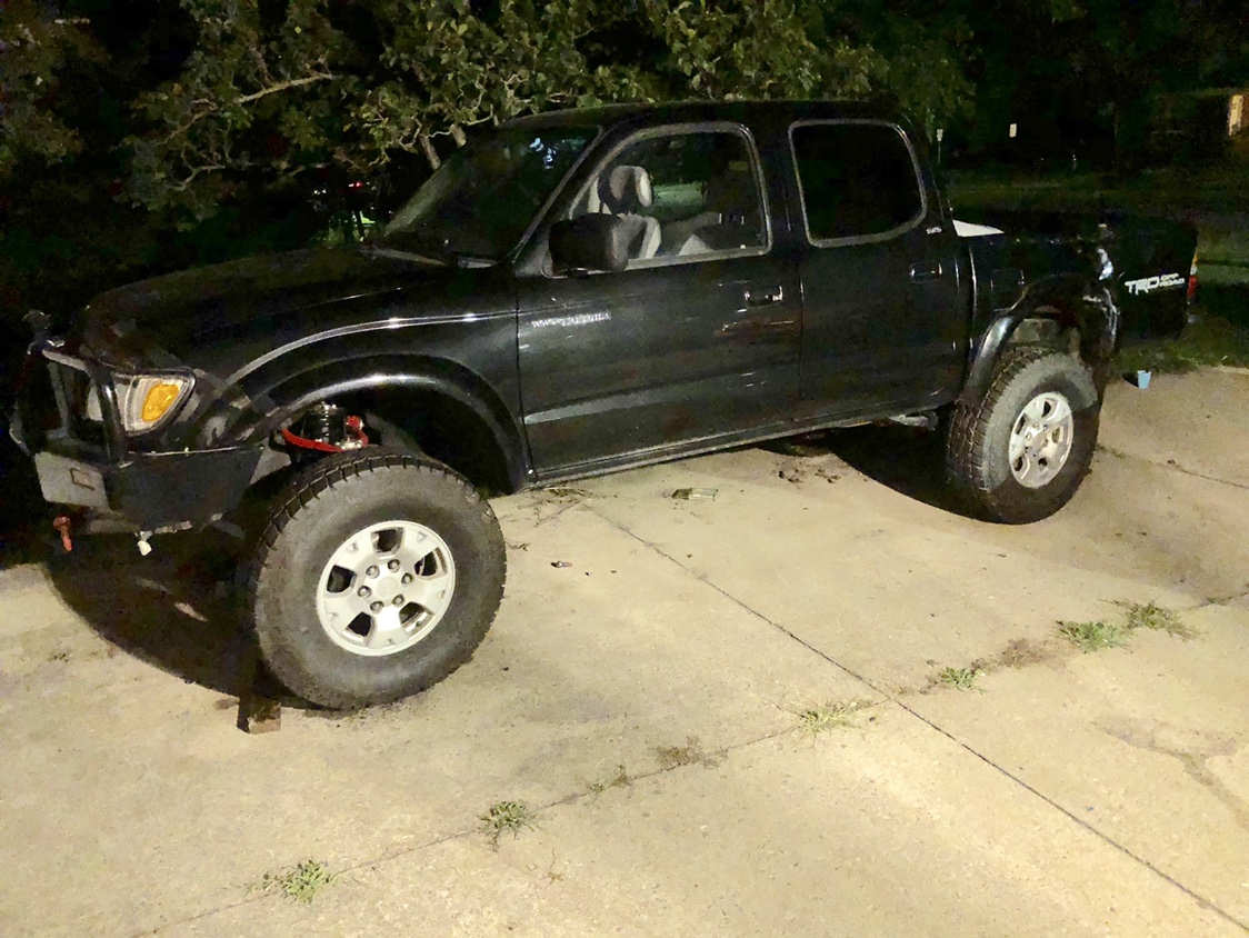

So, I’m rebuilding the Tacoma after my accident and beefing up a few things....
Bought a set of used spindles, had the Total Chaos gussets installed, painted them, installed them... and realized the spindles I bought were from an ABS truck and my truck isn’t. So.... now I have a big threaded hole on each side. Anything wrong with just closing it up with a plain bolt?
Side note... after months of chasing parts, sourcing skilled labor, and in between full time work, full time time single dad stuff and moving... the Taco is actually sitting on the ground.
3” Old Man Emu lift kit, Total Chaos spindle gussets, JBA uniball UCAs... still waiting to install my winch and rock sliders (have both)
