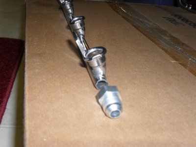

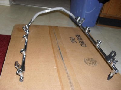

I need to know if I can silver solder 2 fittings for my fuel rail that came off my 2004 cobra motor. I lathed to 8N fittings to fit but I dont know If silver solder will hold or even work. I am trying to make a return line on the fuel rail. I am going to do this ASAP so I need some advice baaaaaad. Here's some pics I snapped. I am gonna sand of the chrome. Let me knowif this will work or not. If not I think I can get it TIG welded....:gr_confus
I forgot to add that will put one on both the left and right rail.

You should have posted before you milled off the end. You can put a spacer on the FRPS sensor and run your AN return line from there.
--Joe
