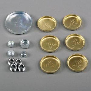

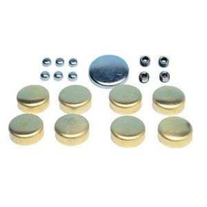

It sounds like the fit isn't quite right on that hole.
Or it's building an extreme amount of pressure in the cooling system.
They make a thin lip (cheapo, Auto Zone, Advance ect...) and a thick/wide lip
The thin lip ones dont seat very well and will pop out, This happened to my brother on a 501 BBF, put the thick lip in and never happened again
