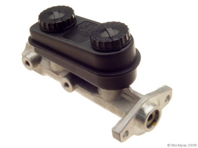

i have the plate all mounted on the car, but what master cylinder do i use? all the ones i seem to be finding does NOT have the fitting for the brake that goes on the bottom side, only the 2 on the side. are the ones im finding wrong or do i have do something with that brake line??
I believe the skinny Kid kit uses a mopar master
And there isn't a line on the bottom , just a ft and back
yea no line on bottom just 2 on the side andacutally they will be on oppiste side..
im almost 100% positive that its a chrysler master cylinder from a 89 caravan
1991-1992 Chrysler LeBaron 3.0L V6
1990-1993 Chrysler New Yorker Non-ABS
1990 Chrysler Town & Country
1989-1994 Dodge Caravan
1991-1993 Dodge Caravan Non-ABS
1988-1989 Dodge Dynasty
1990-1993 Dodge Dynasty Non-ABS
1989-1994 Dodge Grand Caravan
1991-1993 Dodge Grand Caravan Non-ABS
1984-1988 Dodge Mini Ram
1984-1987 Dodge Royal Mini Ram
1991-1995 Dodge Spirit
1993-1995 Plymouth Acclaim
1988-1994 Plymouth Grand Voyager
1991-1993 Plymouth Grand Voyager Non-ABS
1988-1994 Plymouth Voyager
1991-1993 Plymouth Voyager Non-ABS
