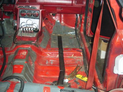

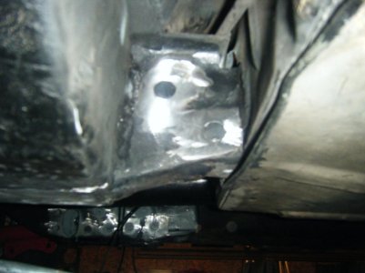

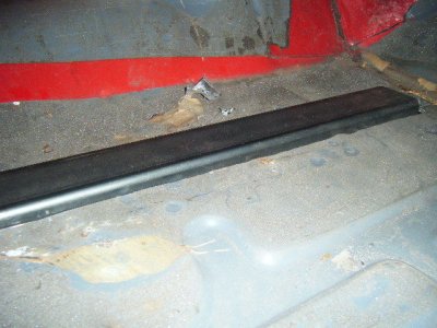

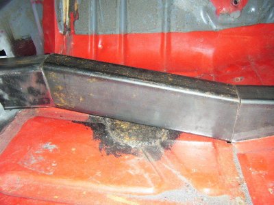

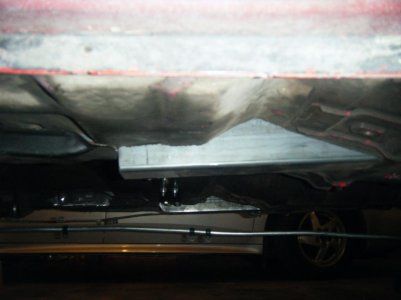

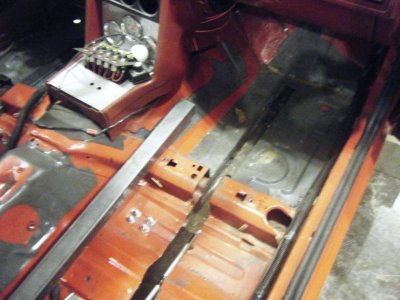

I attached some pictures of what a guy did on corral.net
more
one more.
I like how he tied into the rear subframe.
