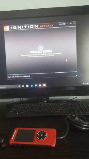

I bought a superchips handheld recently and it really is a good product for what it is. Gives lots of cool little options like tire size and shift points!
