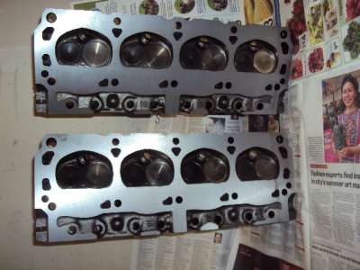

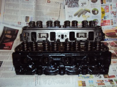

I have a set of 1970 D0OE 351W heads. They have had a lot of work done to them. On the intake side they have over sized 1.940" stainless valves, gasket matched to Felpro 1262, runners enlarged and smoothed, bowls enlarged and blended. On the exhaust side they have over sized 1.600" stainless valves, gasket matched to Felpro 1415, runners enlarged and smoothed, bowls enlarged and blended. They have been machined for guide plates and screw in studs, plates and 3/8 studs included. They have new TrickFlow hydraulic roller springs with 125lbs on the seat and 320lbs at .600" lift and new valve seals. They are fresh from the machine shop with Serti valve job and surfaced to true them up. Asking $450.

Chambers have been smoothed but not really enlarged, stock is 59.5/60cc, add a little for smoothing and take away a little for resurfacing, right around 60cc.
