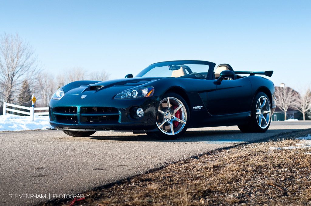

Steven Pham showed up to take some shots too. Here he is setting up:
Steven's pics:
