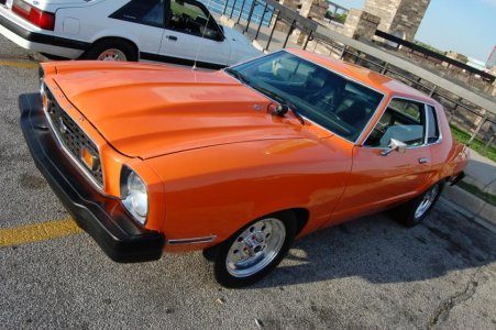

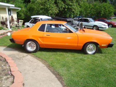

I used rivets( glassed over) on a stock steel hood on mine 6 years ago and made the cowl, bumpers to and had no issues or cracks, yes the underside dont look that great but w/ a car that you cant find parts for it worked .....
the buckle in the front bumper is from me (i have a very bad temper)
these pics were taking last year (08)... did all the glass in 02
