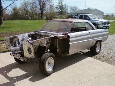

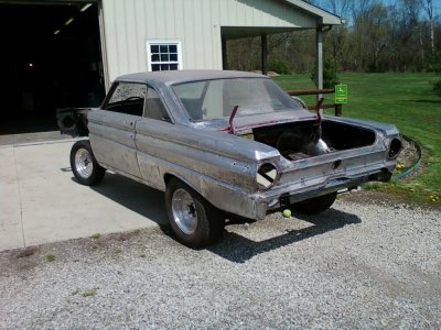

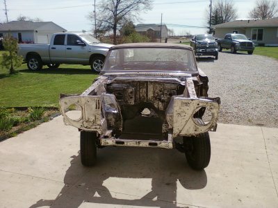

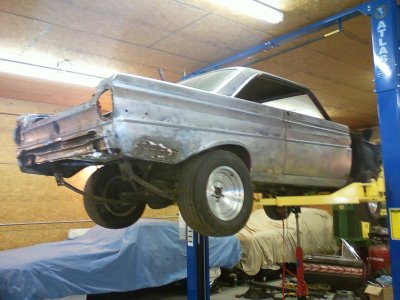

Jeff welded in my subframe connectors today so I snapped some pics of his project while I was there. A few of you have met him and sold or swapped parts to him. I'll let him put out some details but I know he has had the car for over 20 years and it has sat since he got married about 10 years ago and he's planning on driving it this year hopefully........

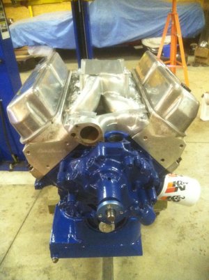

Thx guys! I got the car in 1990 when i was a young lad. It did set mothball for about 10 years until i got some funds to wrench on it. Motor is an 87 roller motor 12:1 domes, edelbrock heads, tfs stage 2 cam. Tranny is a tremec tko 500, 8" rear with 4:11 gears.
I realize just how hard it is to restore one of these old birds. Got her to bear metal after 5 gallons of chemical stripper. Body was pretty solid for the most part. Had to hang two lower quarters, tied the frame, and made a custom export brace. Refabed the front core support to accept the biggest fox body radiator i could find.
I fabed my own hydraulic clutch setup and converted the car to four wheel disc brakes.
In the process of bodywork now. Hopefully make a test run sometime later this year.
