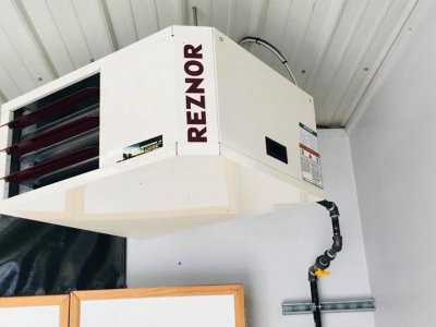

What's the cost on that one a couple posts up?
The unit will usually run $500-700 depending on BTUs. 75k BTU Modine Hot Dawg is ~$675. The Reznor is probably a bit cheaper. Install could vary widely depending on NG piping requirements, roof vs. wall vent, etc. I installed mine in 1 day as a DIY, but I already had the main gas pipe run to the garage - just had to tie it in, new branch circuit, thermostat run, etc. Pretty easy TBH -running the exhaust is hardest part.
I'm in the market (like need one in the next 3 weeks) for a hanging gas one like pictured above, but a bunch bigger. Anyone have a recommendation of where to go for that? Will need it installed too, and it's probably 15-20' up.
If you're looking to DIY, or buy the unit yourself and hire a pro to do the install, I purchased mine from this place about 12 years ago. No issues/problems and they're still around. You'd want to price shop them to make sure they're still competitive. I don't have business interest in them, only pointing to them from personal experience. If you're looking for a pro-install, you might want to visit the Modine website and search for local contractors.

The one I posted apparently uses the same tube for intake and exhaust?
Known as direct vent. Hot exhaust in the center, surrounded by cool air intake. ( () )
I don't believe the Modine or Reznor are direct vent. Just standard B vent. I know mine isn't DV.
