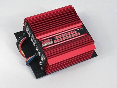

ok quick ? which i know j-quick or 388monte will know the answer for me!
if i was to use a dual stage kit! and i only have a digital6plus ign. how do i retard the timing for the second stage? the digitial6plus only has capiablitys to retard 1 stage! do i just have to add a msd timing retard to my digitqal6plus ? if so what part # etc and how do i wire it in the box? or do i have to upgrade to a digital7plus?
any help would be great!
thanks mark
Run your timing for the frist stage and use the retard for the second stage. I figured your a expert you would have known that.

you will just have to run the timing like jake said or get a dig 7 box with multi retards. that is what i have so i can pull timing out i think 4 times, i know 3 for sure.
get 1 of these
will do 4 stages, each stage w/ up to 9* of timing (per stage) or a total of 20* !!!
part# MSD-8975 ...$266.10 or the one i have in the garage for $150 !!!
