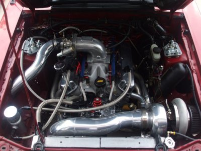

So I'm probably going to have to route my dp to dump up front as I don't think with my turbo placement I will have any other options. Is there any alternatives to running it out of the fender? Can I dump it in front of the tire or is that a no-no? I'm not so sure I want to cut a hole in my fender
In front of the tires a bad idea. Coolant or oil coming out of the exhaust if you frag something... Ouch
You can just dump it straight down instead of outwards, will be mega-loud due to the resonance of the exhaust blasting down into the ground though.
