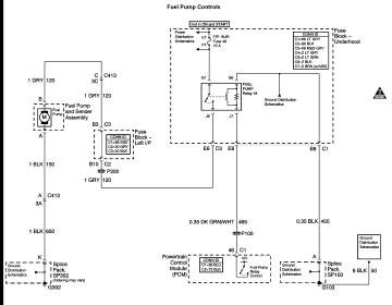

Engine will turn over fine (Cranks & has spark) but fuel pump isn't running.
I checked the fuse. The fuel pump and injections run on the same fuse. Checked the fuse and Fuse is fine (checked with Digital Meter).
I checked the F/P relay. It works.
Fed power (12v) to the relay and the Fuel injectors clicked (working), but fuel pump will not turn on.
Jacked up car, crawled under it, found F/P harness, applied 12v power and I can hear the pump run.
So... the fuel pump DOES work, but for some reason it appears the cars PCM will not give power to the F/P relay to turn on... Why is this?
Suggestions?
where did you apply power on the relay. The injectors shouldn't click cause I beleive they are ground controled by the pcm along with the fuel pump relay
If the PCM does not see a crank signal then it will not turn the pump on. Or if the crank signal is out of phase with the injector timing. I know you said you had spark but is it coming in at the right time ?
Could this problem be linked to the GM theft deterrent? I'm thinking the theft system is acting up, maybe the PCM isn't telling the F/P relay to energize. Can I shut the GM theft deterrent off W/O a GM Tech2? thoughts?
the pump should stil cycle at key on
theft deterant kills the injectors
Open up the fuse box and check the pins. Alot of times they will corrode and or burn out. Also on some models the pcm is a high side B+ signal instead of ground. I would doubt it is a pcm failure. I would check the switching pins for power/ground and if that checks out look for continuity to ground from the relay output power pin. 87a or pin 30 pins 85 and 86 are gonna be the relay switch control circut.
