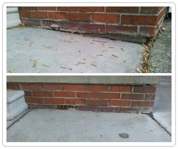

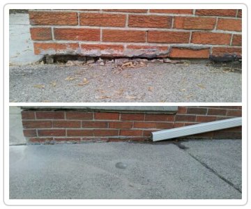

I had a lot of work done on my driveway this summer and it was massively less expensive than replacement (about a quarter the cost). They used different mixtures based on what they needed to do. They did a great job and actually did more than we talked about just to get it right. I was extremely pleased. Here's a couple pics of the front corner.
that downspout placement is terrible and will prob wash all of that out again if you don't move it.
I was a service manger for a new home devloper this was my prefered way to repair slabs that washed out because I didnt have to mess with landscaping or sprinkler systems price was between 1/3 to 1/2 price of a pull and repour
when the right guy was doing it I never had another problem the only draw back was the grouted holes but you get over that quick when you have the extra grand to spend on your car
yeah bring it past the house there or maybe turn it out onto the driveway
LOL - that downspout isn't what is normally on there. That was just a piece to get my by for a short bit when the work was done. The 'normal' one comes to the end of the porch, and sucks ass because it lays down a sheet of water/ice that you have to walk through just to get to the front door. I had a delivery come and it apparently got crushed when the geniuses drove over it as it was swung away from the house at the time (for some reason). Turning out toward the driveway is a possibility...but again, there's no good way to do it as my cookie cutter neighborhood leaves no room for anything between the neighboring houses. Whoever did the gutters on my place should be smacked in the head.
