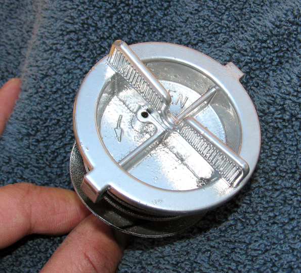

I've powder coated plastic with success before, it can be done depending on the grade of plastic. Here's a pic of a piece I have done dozens of in chrome powder:
That resevoir came out pretty damn good. Quality work with quality materials gets high pay so not too worried about the cost. I just want it right and it to last. I recently was involved in the purchase of a warehouse that had a large quantity of house of colors paints and pearls so the rest of this project is gonna be bad ass so not looking to skimp or do anything cheezy.

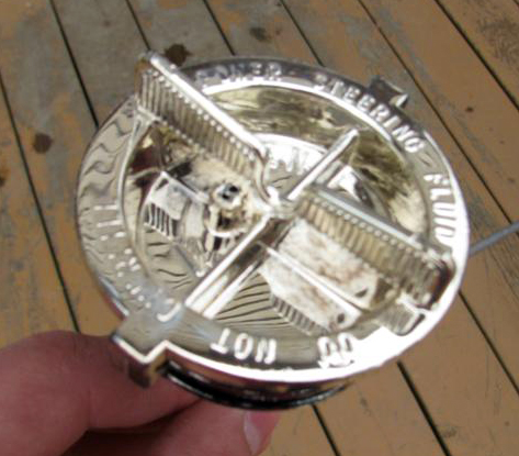

It came out looking just like chrome, but after it aged while being on the car (not even 500 miles on it) some areas dulled out to a finish that wasn't even as good as a polished look. I'm taking it off the car this year because I'm sick of looking at the regressing quality. The cap still looks good though.
That's the big issue about the spray chrome: lasting quality. I put in countless hours of research when I was ready to buy a $10K system, no matter which mfr it was they all had people on forums everywhere going on and on about the varying quality between chemical batches, yellowing, dulling, lifting, etc. I was ready to deal with some hit or miss production but when people are losing 2x the cost of the machines because of inconsistencies of materials, that was not worth the risk. The bad part is they'll come out looking great but down the line...who knows!

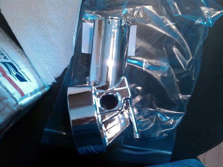

Cosmichrome is the stuff used on that reservoir above. The cap was done by different methods.
The owner of Gold Touch Inc. in Ohio, a distributor of the Cosmichrome system, actually did that reservoir in-house for me as a sample product when I was sourcing their equipment. I even went down there for a day to use it all. I think because of the hard edges of the reservoir around the fluid line nut, it's caused the discoloration. It looks like it's been stressed just sitting there while the rest of the flat/round areas still look perfect. Just an FYI. I'd say on your wheels you shouldn't have to worry about anything though. The Cosmichrome system is cool and worked as it should have when I used it.
