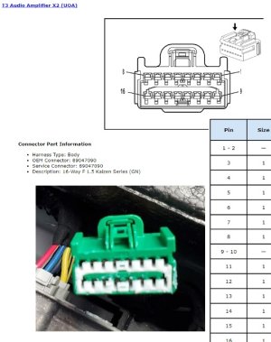

My multi-decade project still underway. Stuck on the electrical now - would prefer not to cut the harness, but nobody is making a T-harness. Here is the connector I need to make a "T" for. Hoping for some help finding this part. I can get the part listed from the dealer, but I need to find the mating connector to make the "T" harness. They usually come in pairs.
Tx.
Geoff

I already have a similar one to that from them. That one only has the two front door mount speakers - which is enough to get a subwoofer. It also includes power and ground and two wires are not used in the convertible. The remaining dash, center, and rear seat speakers are all on the 16 way. I am on the fence again - the Nav-TV units which decode the MOST signal into RCA are back in stock now for $600, and by the time I buy all these harnesses, and line out converters, it might actually be cheaper.
I actually called the head engineer from Bose and asked him to tell me the crossover points for all the speakers and he told me it was proprietary to Bose - not GM. Why does this have to be so hard!
