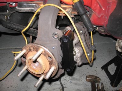

1) The Trackbrackets bracket installed with the lower nub shaved on the spindle. Stock caliper in the background.

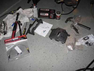

2) all the stuff laid out

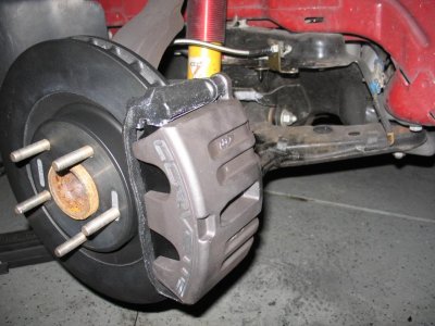

3) complete with GM C6 rotor. I now run the cheap $20 C5 rotors
is the factory mount still usable after it has been shaved?
Unfortunately not. The bottom nub is as large as the top one that is still there in the pic and gets shaved completely off. I sprayed some black paint on the spindle where I cut it.
