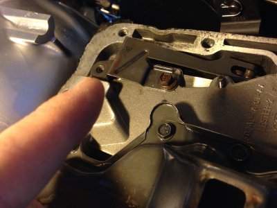

image.jpgHI. I need a valve body bolt for a C4 trans. Specifically I need the longer bolt that retains the linkage clip. I'll buy the whole set if I have to in order to get this thing done. Please let me know if you either have some to sell or know where I can get this bolt.
Thanks in advance!!
That spot takes a standard length (same as all the others.... only one bolt on top of the filter is longer) If you need something longer measure the depth of the hole and a local hardware will have one. The thread size is 1/4x20.
If you need a standard one pm me you address and I will mail you one. Early models (64-69) used 7/16 headed bolts...70 and up used 3/8 headed bolts. Rich
