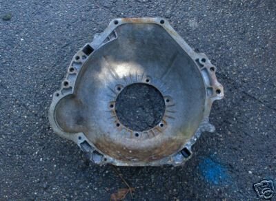

I'm a little confused. When I bought my trans the guy gave me a flywheel for an AOD but this is the bellhousing that was on the trans. Is this a bell for a 157t or 164t flywheel?
thanks

This is the part number on the back of the bell if anyone knows how to identify it.
RF-D7BP-7976-AA
Hey Saso,
I already took a measurement and it's 6.25 deep so it's a 164t. That's good to know about the block plate because I might be switching over to 157t.
thanks
No Prob......
That's why JW/PA/Every other SFI approved C4 Bellhousing gives ya that ring(spacer) with thier C4 Bellhousing.....

Is there a benifet to a 157?
Just for Header clearence You can also measure from the top starter bolt hole to the next bolt hole above 1-1/2 = 157 1 3/4 = 164

yeah, and if anyone needs one of those spacer rings, I think I have one here somewhere
