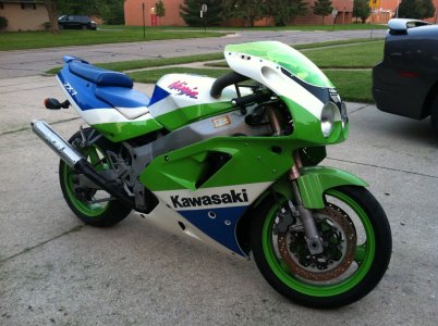

Well, that's project #2. A real deal 1991 Kawasaki ZX-7R. For those not terribly familiar with them... from 1991-1994, Kawasaki's 750 was the ZX-7. However, they also produced a limited number of ZX-7Rs. The R was built for homologation purposes, to allow Team Green to enter it in WSBK competition... it came with a stronger engine (compression, different cams, etc) that made 122hp vs the standard 100hp. It also included fully adjustable front and rear suspension, flatslide carbs, and was almost 25lbs lighter due to things like an aluminum gas tank, minimal subframe, solo seat, etc.
So.... while I was sitting on the pile of parts mentioned above in project #1... I just happened to stumbled across an ad on CL in Connecticut for a "ZX-7" but immediately recognized that it was actually an "R". I called that day, wired the money and had it shipped.
Arriving home:
It doesn't run and has a cracked upper fairing..but the price was right for what it is. I paid $2000. Nice 7Rs have pushed north of $10,000 on eBay recently. Mine will NEVER be that nice, but I'm hoping to return it to 8/10 condition and actually ride it.

Look what actually ran today. Rode it around the block. First time it's moved under it's own power since I have owned it :)
