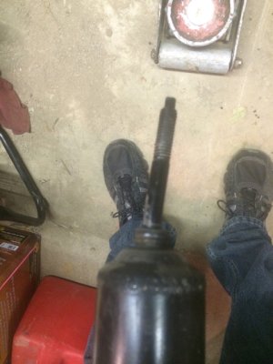

Bent shock?
MarkVIII93
Anybody ever see this. Pulled my autozone shocks off today and found they were bent.
Um, are you sure that you have the correct shock? Are your springs sagging? If your springs are worn and constantly riding low you can run the risk of bending a shock.
