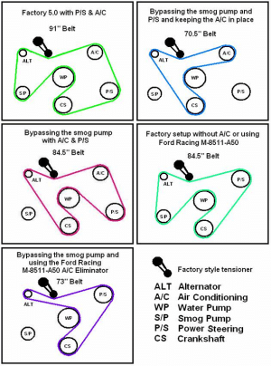

FoxbodyJr. Club Member Apr 26, 2012 #1 I'm wondering what size belt I need for a 5.0 foxobody if I take off the stock air system? I was wondering if somebody knew so I don't have to do trial and error
TooSlo86 Club Member Apr 26, 2012 #2 Take an old belt and cut it, mark what you need and go to advance auto. I'm sure I had one in the shop when you stopped over the other day! Try this;
