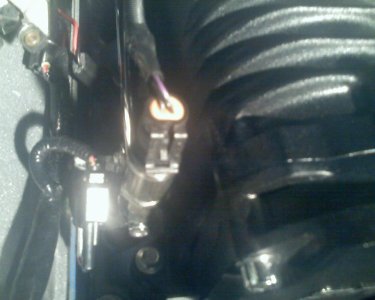

anyone have one of these on their car?
Here is a quick cell phone picture.........
Right front = black
Right rear = purple
Left front = grey
Hope this helps.
