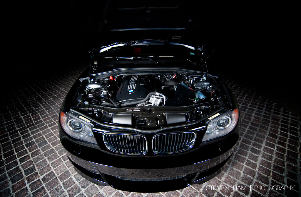

Next was the engine bay. Also fairly clean to begin with, we applied FK1 #1119 to the backside of the hood and hood catch to loosen grime / grease. Jacob removed the windshield washer nozzles in anticipation of polishing, and the engine was doused in degreaser, agitated lightly, and then pressure washed off. This was repeated at least twice everywhere, with more attention to areas that needed it. Once clean, we blew the engine dry and applied water based dressing for a beautiful silky even finish that would quickly dry (and therefor not attract dust)
After
