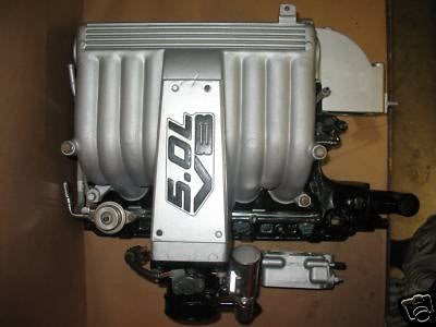

anyone ever seen this gt40 intake?????????????????
I thought I knew what it was a 93 cobra intake. til i opened the box. Maybe a prototype for the 94-95cobra?
Explorer intakes look a bit different. They have lines along the back of the plenum and the badge screws on like the stock mustang intake
F3 = 1993
J = industrial
L = Ford Parts and Service Division; Industrial Engine Operations
9424 = manifold; fuel injection as far as I can tell
ca = this is the design level, "CA" instead of "AA" indicates some sort of change, probably the EGR bore.
